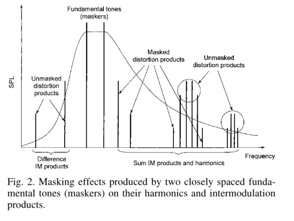

Graphing, Interpretation, and Comparison of Results of Loudspeaker Nonlinear Distortion Measurements
scarica qui
scarica qui
