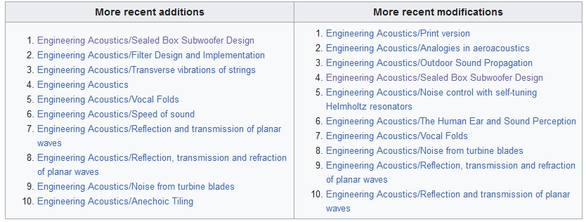

https://en.wikibooks.org/wiki/Category: ... _Acoustics
Libro completo "Engeneering Acoustic":
https://upload.wikimedia.org/wikipedia/ ... ustics.pdf
